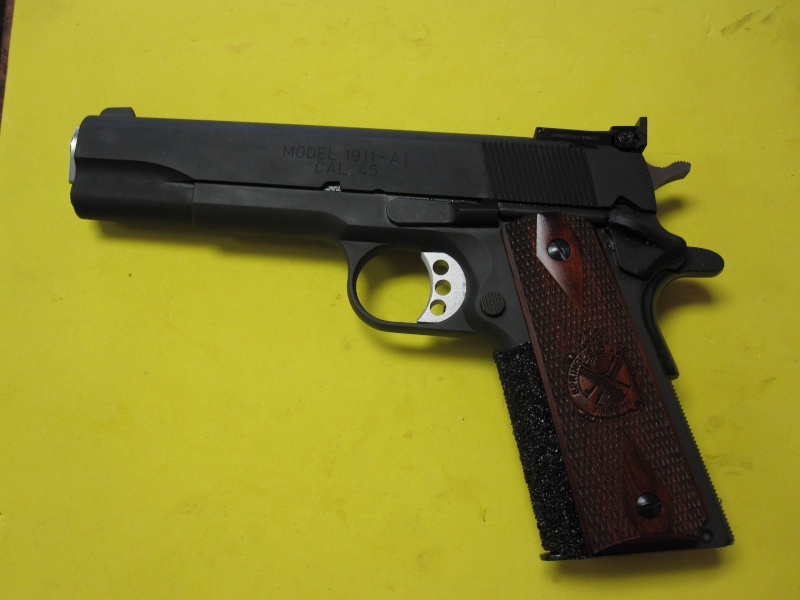

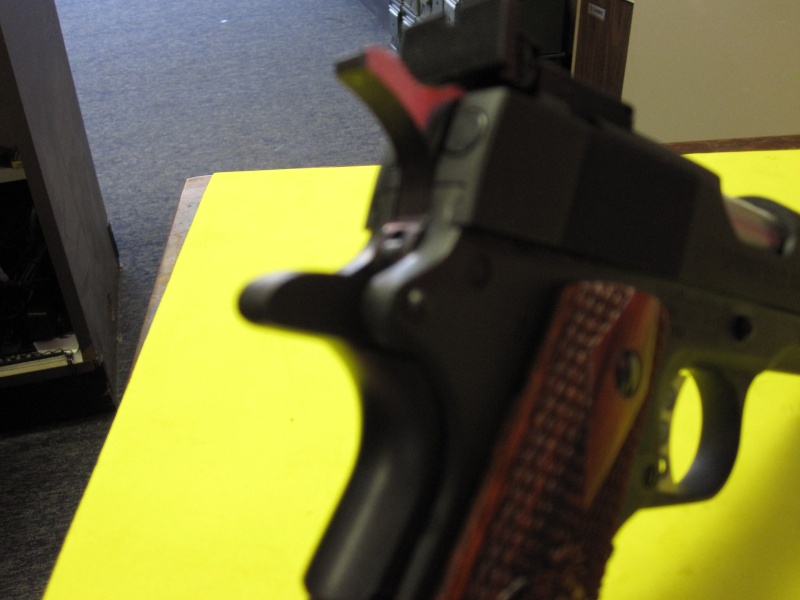

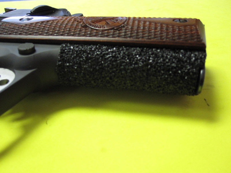

Post by DavidR 4/25/2014, 4:18 pm
Well my ordered Range Officer came in the other day. Very Pleased, cost was 700.00 I asked the seller who said they had two to pick me out the one with the tightest frame/slide fit which they did, its very tight but function's slick. So I commenced to transform it to a CMP Legal Hardball gun. It was simpler than I thought, picked up a standard hammer, grip safety & thumb safety. Everything dropped right in with only a little filing on the detent area on the thumb safety. Trigger was 6lbs and terrible, Part of this is due to the safety built into the mainspring housing which I did also change out to a old one I had already but that is a option, Some might try and just take out the guts and replace with old style but that is not legal as you would still have the safety mainspring but not in working condition. If left in place it must function as a safety is my understanding of the rules. I then  took the sear and polished it and the hammer hooks ,adjusted the spring and came up with a tolerable feel which will hold 4.25lb it will do for now, later it will get a better trigger job. I added some grip tape to the front strap and its ready to go. Ending total 775.00 but I bought  new take off parts. Id say total cost of parts if buying from midway or brownells about a 100.00 bucks + cost of the gun. This is probably the best bang for the  buck for a ballgun that actually is good enough accuracy wise to leg with.
If your a DIY kinda guy for have friends that are this is a easy way to get into competing in the CMP program.Springfield Range Officer Hardball Gun build - Page 2 Img_0515Springfield Range Officer Hardball Gun build - Page 2 Img_0514Springfield Range Officer Hardball Gun build - Page 2 Img_0513
