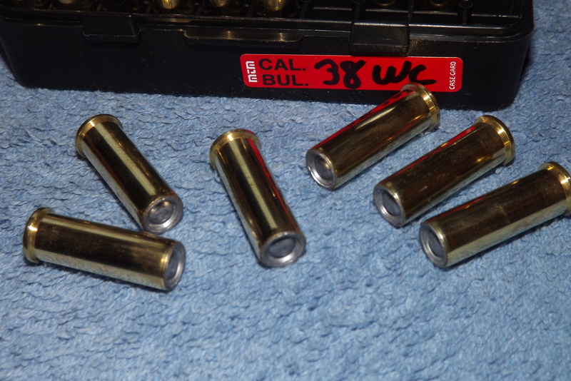

I am quoting an article by Gil Hebard on page 104 of The Pistol Shooter's Treasury.
"Many reloaders do such a poor job that their bullets are actually lobbed out of the barrel, thus many print broadside-on at 25 or 50 yards! If your bullets are doing this, you can bet your bottom dollar that your loads won't group better than perhaps 15" at 50 yards, even out of the finest gun. In just about every instance, this is the fault of the load, not the gun."
I did not do very well at my first target session with the S&W Model 52. I assumed all of my issues are due to my shooting, not to the gun... ...BUT... I am only a novice reloader. I thought I was doing a good job, following instructions, Magnus ##514 bullets, 148 grain, .357" diameter, over 2.8 grains of Bullseye. I showed one of my bullets to someone at the range who told me it was fine. I just took close-up photos. Is there anything obvious that I'm doing wrong, based on these photos? The second photo is a comparison over Winchester Factory ammo. Maybe I just don't know enough yet to realize what I might be doing wrong.
Larry Meyer at RCBS made me a seating die to properly seat the rounds. There is minimal crimp - maybe I need more? At first, I was "shaving" off lead, but adjusted the dies until that no longer happened. Based on how little I know about reloading, and how critical it apparently is for the Model 52, maybe my accuracy problem is my own fault. The first photo is of many rounds... I can't see anything wrong, but.....

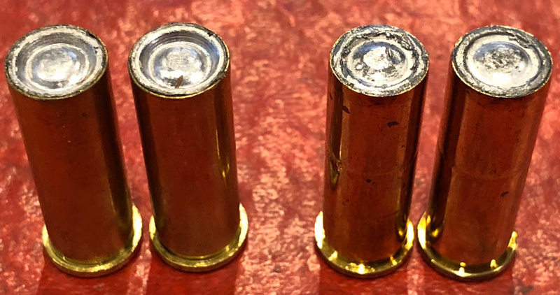

Two of my rounds (left) compared with two Winchester 38 Special 148 grain "Super Match" factory loads:

I am seeing a dark line around your bullet that is not present in the factory ammo. If I had to wager a nickel I don't believe your putting any/enough crimp on the bullet. I use a distinct visible roll crimp on mine. Some use a taper crimp and some use both. I wouldn't use BE without using any crimp.
LenV- Posts : 4589
Re: Attempting to load for the S&W Model 52
Len, you are correct. For the factory rounds, starting just under about 1/32" from the end of the case, the brass tapers inwards. When I first set things up, I had just the smallest amount of taper. Using my fingers as a gage, the rough edge at the end almost feels like it tapers out, not in - but nothing I can measure.
Gene's ammo doesn't have any taper, and I can't feel any taper, but looking at the end of the bullet, there is just the tiniest amount of taper - much less than the Remington round.
So, the appropriate thing to do is to re-adjust my seating die, and increase the taper? Maybe I can use another die to ONLY increase the taper a bit more..... for these shells, and then to start all over again for the future.

One of the good things about being a "pack rat" is I still have a ton of old gear. I've got my old RCBS Big Max press next to the progressive press. Going through my dies, I found a Lyman 38/357 taper crimp die. I put that die in the Big Max, and worked with an empty shell until it started tapering.
The OD of the shell was 0.373" diameter.
The OD of the end of that shell now, is crimped to 0.368" diameter.
Is that a good taper, or should it be more/less?
The Winchester round is crimped to 0.370" as best I can measure, but at the very end I think it is less.
The Winchester round has an OD of 0.375"

As Len pointed out, you don’t have enough crimp, IMO. Your load is fine. So I would take your remaining loads and crimp them as follows: no more crimp, crimp to 0.005 mouth diameter reduction, 0.010 reduction and 0.015 diameter reduction. I bet one of the latter 2 will shoot best. I’ve always used a roll crimp, FWIW.

If you are taper crimping (and it looks like you are) measure the crimp on the factory Winchester ammo and try to duplicate that. I'm of the opinion, having shot a few thousand of factory match .38 SPL wadcutters, back in the day, that Federal and Remington started using a roll crimp to aid PPC shooters in loading their revolvers during matches. I don't remember Winchester ever using a roll crimp.
BE Mike- Posts : 2206
I went back to the RCBS Pro2000, with the #18212 dies, which includes a roll crimp / seater die. I adjusted that to match the Winchester as best I can. The photo below shows how well/poorly I did this.
Both rounds now "feel" the same. The diameter at the end of the taper is close enough that I can't measure any difference. The angle of the crimp seems to be different, but I don't think I can do anything about that. Hopefully this is adequate.... and if you can't tell which is mine, and which is from Winchester, that's good!
