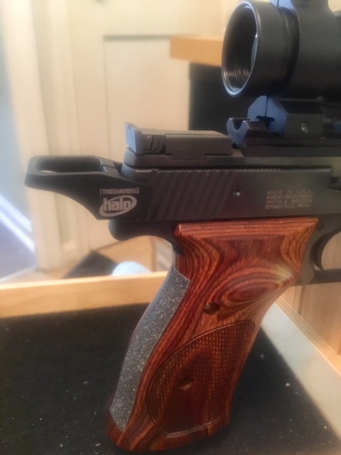

In follow up, the SW22 halo "charging handle" arrived yesterday. I installed it on my Model 41 and found I did not need to remove any metal from the clamping screw as was described in the rimfirecentral.com post. It clamps in one groove of the slide serrations, and there is no play. I didn't weigh it before installation, thinking I would get from the manufacturer's spec, but they don't provide it. I didn't want to take it off again, and the weight had seemed negligible.
I haven't gotten out to shoot yet, but I am anticipating good things as I can operate it easily with the index finger of the hand that was operated on. Below is a picture.
