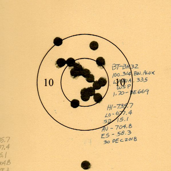

Here are results of my Bear Creek tests, thus far...
Pardini HP barrel in mechanical fixture.
Distance is 50 yards.
Target below is with the 0.314" H&N...
![Bear Creek 32 long HBWC test 000110](https://i.servimg.com/u/f41/19/60/91/34/000110.jpg)

Wow, very interesting Dave. Re swaging thr BCs seems to get them close to the bumped Speer/HN bullets, perhaps equal if sufficient tests were done ??
The bumping process with the Plinkers obtains extreme consistency in size and shape. I guess I assumed that what really helped in accuracy was increase in size, not so much the shape?
I also concluded the size was critical primarily because the std Plinker is smaller than the Pardini barrel, since they shoot much better in my guns with tighter barrels.
The few BCs I had were right at .314, so what part of your reswaging do you think helped the most, the HN shape, consistency or the slight increase in size?? Boy, this is easy stuff:lol!:

The owner of Bear Creek Bullets is following this thread. I just emailed him, and based on Dave's results, I suggested he strongly consider making his bullets at .3145. It will be nice to have a USA based company that can make 10 ring bullets for the .32 wadcutter.

Dave, have you had decent results with the standard unswaged new style Speer Pinkers in any tighter barrels, say .308, or .312. Perhaps with one of your Benelli or GSP barrels?
gregbenner- Posts : 738
Join date : 2016-10-29
Location : San Diego area
Re: Bear Creek 32 long HBWC test
I do have some test targets fired under the following conditions...
Custom 10T 0.311" barrel (Pardini HP NEW configuration)
50 yards via mechanical rest.
Speer Plinkers as received, no "bumping".
FC (Federal brass)
Winchester Small Pistol Primers
1.27 grains (0.155cc) Hodgdon TiteWAD (Undocumented Load)
Taper Crimp to 0.325" at mouth.
![Bear Creek 32 long HBWC test 10t31113](https://i.servimg.com/u/f41/19/60/91/34/10t31113.jpg)
![Bear Creek 32 long HBWC test 10t31114](https://i.servimg.com/u/f41/19/60/91/34/10t31114.jpg)
![Bear Creek 32 long HBWC test 10t31115](https://i.servimg.com/u/f41/19/60/91/34/10t31115.jpg)

Thx Dave. The reason I asked is because I have suspected that, with the limited availability of bullets, and the cost of a swaging tool, it might be more cost effective to rebarrel.
I assumed the 10T in the description indicates a fast 1:10 twist?
How much significant might you ascribe to the faster twist v size?
Greetings Greg,
Yes, 10T = 1:10 twist.
