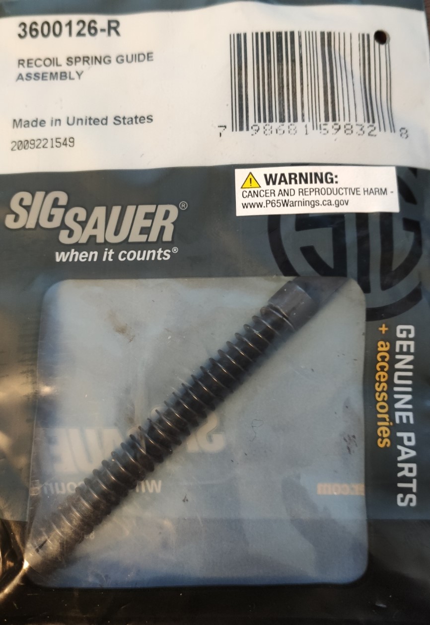

I just received a free replacement recoil spring guide assembly from SIG USA (after repeated phone/email and a wait of several weeks). The little retainer at the front end came off and disappeared (seems to be a common fault).
Without the retainer it is a serious PITA to get the assembly off and then back on the barrel for cleaning.

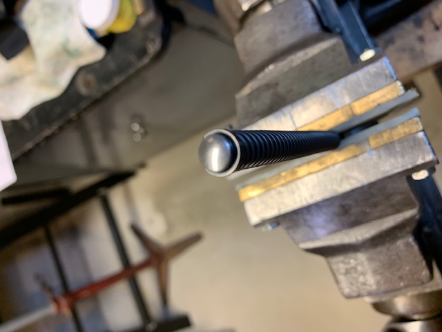

I got a replacement, then chucked it in a lathe and used a file to turn down the OD of that swaged button on the muzzle end. Naturally, after a few minutes, the sliding washer and spring were free. I continued to polish it down until the muzzle end of the rod was about 0.001" smaller in diameter than the guide rod itself. Believe it or not, that last 1/8" on the front of the rod STILL broke off after a couple hundred rounds! That's when I decided to make my own design.radjag wrote:I just received a free replacement recoil spring guide assembly from SIG USA (after repeated phone/email and a wait of several weeks). The little retainer at the front end came off and disappeared (seems to be a common fault).
Some people use it with the last 1/8" missing...I would highly recommend against doing that. Not only can you damage the flat spring assembling it, but imagine if it jams?

[size=16][i]"Some people use it with the last 1/8" missing...I would highly recommend against doing that. Not only can you damage the flat spring assembling it, but imagine if it jams?"[/i][/size]
Hmmm - I've shot maybe 300 rounds with the swaged button retainer completely missing! Including two EIC Service matches, one of which I won!
I will install the new assembly and keep a careful eye on it.

I guess as long as the broken guide rod extends to or past, the muzzle end of the sliding washer (with the slide closed), it should not jam.radjag wrote:"Some people use it with the last 1/8" missing...I would highly recommend against doing that. Not only can you damage the flat spring assembling it, but imagine if it jams?"
