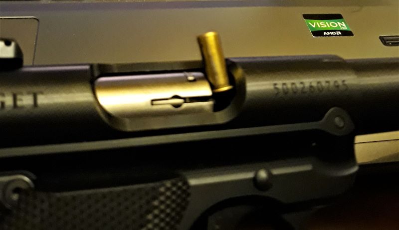

This photo is staged but it is usually something like this:
The new round can be partially in the barrel or held against the back wall of the chamber by the spent casing.
What do you mean when you say the pistol is "presently sprung for some pretty high velocity ammo"?

I am far from being an expert, but what your picture depicts is a stove pipe not a failure to extract. The case has been extracted from the chamber but the bolt has not traveled rearward enough to complete its stroke to eject the case. There are different reasons this could happen. Temperature sensitive ammo, not enough lube, recoil spring etc.

Like Foundryratjim I thought you were explaining a different failure, where the case remains seated in the chamber after firing.
These failures can sometimes be cleared during sustained fire. A quick sweep over the top of the pistol with your offhand (not putting your hand in front of the muzzle) might clear the case and complete feeding. I learned to hold my belt buckle instead of deep in my pocket with my offhand for handling these failures.

mutley wrote:This is a new gun? I'd send it back to Ruger and tell them to fix it.
She was manufactured in 2021. I bought it "used" from a friend who had taken it to the range once (less than 50 rounds he says). Pretty sure he bought it new.
I don't have an aversion to sending my pistol to Ruger but I want to have tried all the things they will suggest (i.e., change ammo, clean, lube) before I part with her for who knows how long. My backup is a 1961 Ruger Standard pistol with the issues you would expect from a 61.5 year old gun. And, I've been told the break-in period for this model varies from 1000-2000 rounds.
